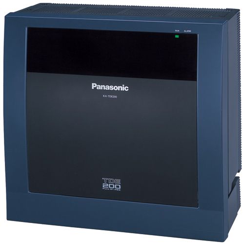

KX-TDE100,200
« เมื่อ: 24 ธันวาคม 2556, เวลา 19:20:53 น. »
KX-TDE100,200 Maximum Trunks and Extention
         Type                                                                     KX-TDE100                          KX-TDE200
Total Number of  Trunks                                                       128                                      128
  Trunk(Physycal Trunk Card)                                                120                                      128
  Trunk(Virtual Trunk card)                                                     64                                        64
      -H 323 Trunks                                                                 32                                        32
      -SIP Trunks                                                                     64                                        64
Total Number of  EXT                                                           256                                      256
  EXT(Physycal Ext Card)                                                      160                                      256
  EXT(Virtual Ext card)                                                         128                                      128
    -IP-PT and IP Sofphone                                                    128                                      128
    -SIP EXT                                                                         128                                      128
 Option List
-IPCMPR Option Cards
  -KX-NS0132       Stacking Card for KX-TDE/TDA Series
  -KX-TDE0105      Memory EXT Card
  -KX-TDE0101      IP Convergence Card
  -KX-TDE0110      16-Ch VoIP DSP Card
  -KX-TDE0111      64-Ch VoIP DSP Card
  -KX-TDA0196      Remote Card
-Activation Key Codes
  -KX-NCS4104      4-Ch IP Trunk Activation Key
  -KX-NCS4208      8-Ch IP Softphone/IP Proprietary Telephone Activation Key
  -KX-NCS4508      8-Ch IP Proprietary Telephone Activation Key
  -KX-NCS4716      16-Ch SIP EXT Activation Key
-Physical Trunk Card
  -KX-TDA0180       8-Port Analogue Trunk Card
  -KX-TDA0181       16-Port Analogue Trunk Card
  -KX-TDA0184       8-Prot E&M
  -KX-TDA0188       E1 Card
  -KX-TDA0288       8-Prot BRI
  -KX-TDA0290       PRI30
  -KX-TDA0484       4-Ch VoIP Gateway
  -KX-TDA0490       16-Ch VoIP Gateway
-Physical EXT Card
  -KX-TDA0143       4 Cell Station Interface
  -KX-TDA0144       8 Cell Station Interface
  -KX-TAD0170       8 Prot Digital Hybrid
  -KX-TAD0171       8 Prot Digital
  -KX-TAD0172       16 Prot Digital
  -KX-TAD0173       8 Prot SLC
  -KX-TAD0174       16 Prot SLC
  -KX-TAD0175       16 Prot SLC With Message Lamp
  -KX-TDA0177       16 Prot SLC With Caller ID
  -KX-TDA0470       16 Ch IP EXT
  -KX-TDA1176       16 Prot SLC With Caller ID and Messagr Lamp
  -KX-TDA1178       24 Prot SLC With Caller ID and Messagr Lamp
-Other Physical Card
  -KX-TAD0161       4 Port Door Phone
  -KX-TDA0166       16 Ch Echo
  -KX-TDA0168       EXT Caller ID
  -KX-TDA0190       OPB 3
  -KX-TDA0191       MSG4
-Power Supply
  -KX-TDA0103       L-Type Power Supply
  -KX-TDA0104       M-Type Power Supply
  -KX-TDA0108       S-Type Power Supply
